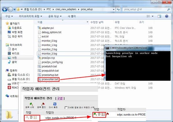

Windchill PDMLink The "Executable Not Safe" message is returned when attempting to start WVS
The flag in the worker agent management
It is displayed in white.
Document 'https://support.ptc.com/appserver/cs/view/solution.jsp?n=CS140965#_ga=2.85968985.1520012805.1500267831-1531925275.1499925517'
But I did not understand this
So double-click proeworker.bat in the installed path
The flag was green when I ran it.
Do I have to run them manually each time I run agent management?

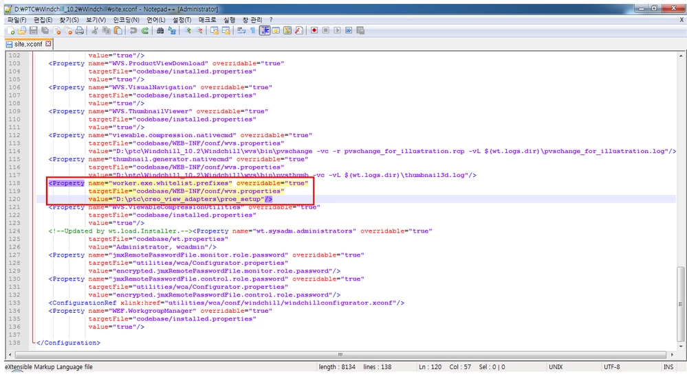

i Add sentence
<Property name="worker.exe.whitelist.prefixes" overridable="true"
targetFile="codebase/WEB-INF/conf/wvs.properties"
value="D:\ptc\creo_view_adapters\proe_setup"/>
but flag was still white..
help me plz
thank you
Jul 18, 2017 1:39 PM UTC
It is not required to run the 'proeworker.bat' manually all the time. Just add the file path of the 'Proeworker.bat' in 'whitelist' property. Add the following Property in Site.xconf, propagate and Restart Windchill.

i Add sentence
help me plz
thank you
Jul 19, 2017 3:37 AM UTC
Did you propagate the properties and restart Windchill?
