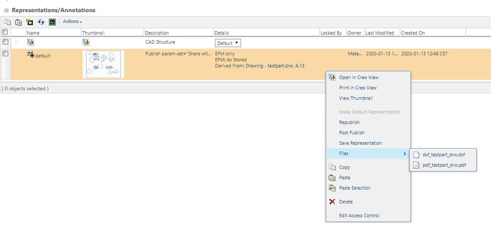

My client wants that generated PDF and DXF from DRW should have the same name as the primary file. Now it looks like this:
Files should be named testpart.dxf and testpart.pdf without prefix "dxf_" and suffix "_drw".
My publish rule look like this:

7 replies
MattPat14-AlexandriteAuthor
Jan 17, 2020 11:24 AM UTC
I see that value output-prefix is mandatory. Is it any way to solve it ?
Jan 17, 2020 11:41 AM UTC
The only possibility I'm aware of ist to create an AfterEDRLoader like described in the case CS216668.
Jan 17, 2020 11:56 AM UTC
Thank you for the quick response. Why PTC can't allow it to make in publish rule. It doesn't make sense. I have to create file and another method will only change the name of this file.
