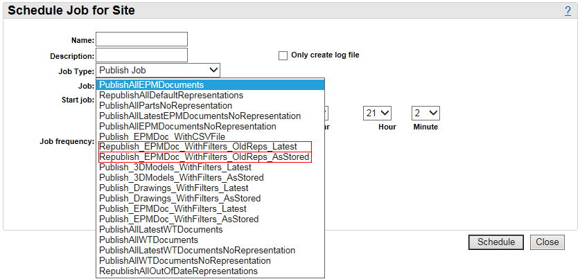

In a previous post, I discussed what I do to reduce the impact of publishing job failures. Since then, I have implemented another custom scheduled publishing job to further reduce the impact. As an attachment to this post, I have included the code required to add this new custom job as a selection in the WVS Job Scheduler Administrator. I added additional code to the files included in PTC article CS211115, so the directions included in the article for deploying can be followed. This addition creates a job called Republish_EPMDoc_WithFilters_OldReps as shown below.

The purpose of this new job is to catch all EPMDoc publishing failures that occur after the state changes. When the job runs, the last modified date/time of the existing default representation is checked against the date/time of the most recent state change. If the representation is older than the most recent state change, it is sent back to publishing.
I scheduled this job to run every hour along with the other recurring job I discussed in this previous post. I run this job more frequently because I know that the EPMDoc has already successfully published. This query only finds EPMDocs that have an existing default representation.
