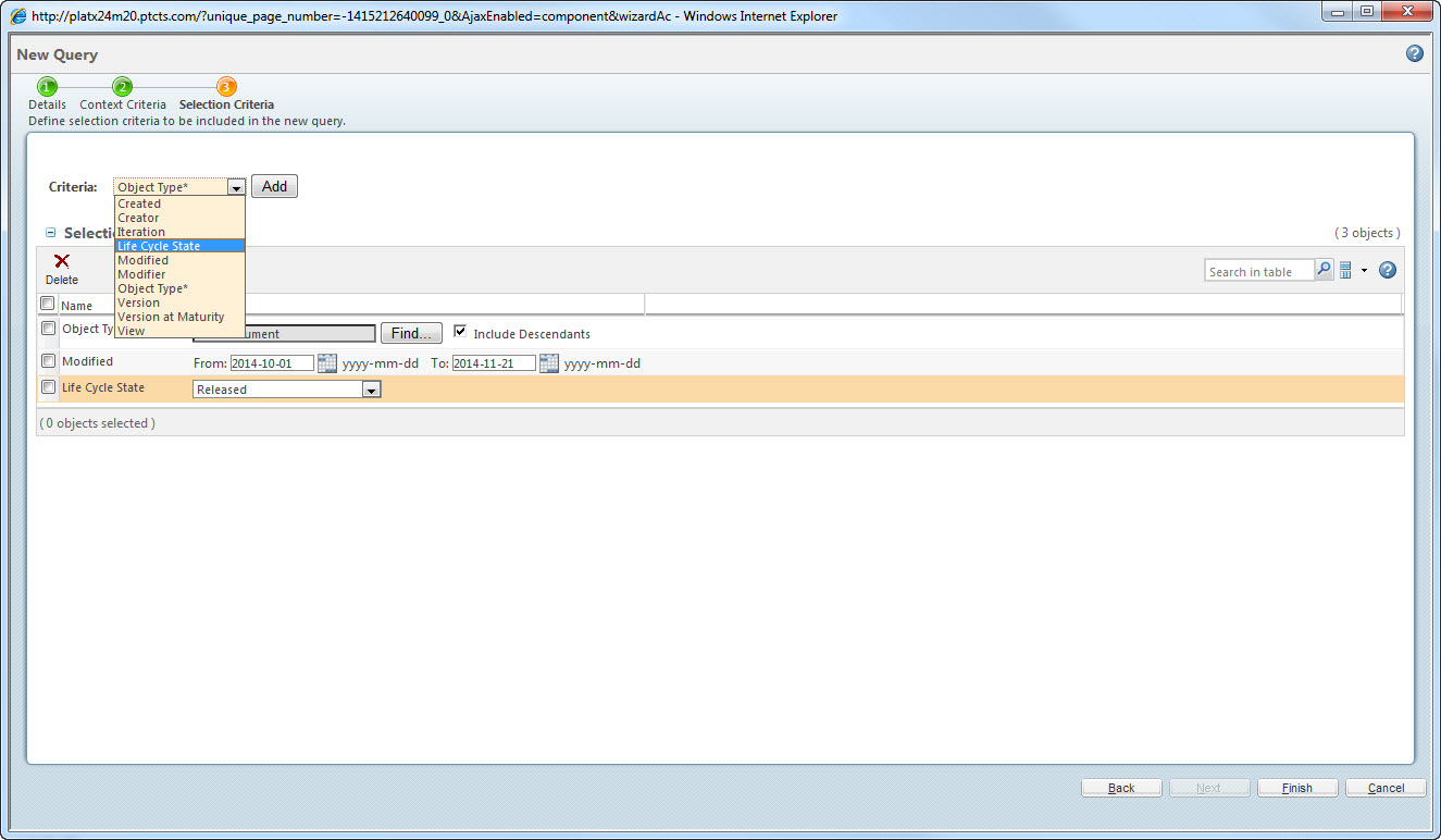

Is there a way to define criteria - to search windchill objects which were released in past 6 months and purge the non latest iterations of the released objects?

It looks like you can search for Released objects that have been modified within a given time frame, but there is no criteria available to check whether the object was specifically released within that time frame:
