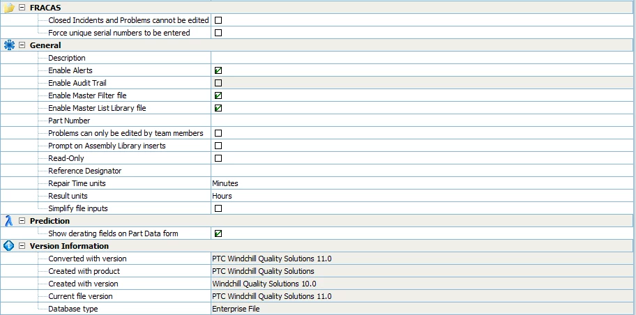

Hello all,
In Windchill Quality Solutions 11 the audit trail can be enabled by going to the file properties of the project. Except in our case the "enable audit trail" option is greyed out and can not be enabled. Appreciate any comments on this.
Oct 24, 2018 3:57 PM UTC
Audit trail logs depends on the license you purchased from PTC. In case if you do not have this purchased, this will be grayed out. Hope this helps.
