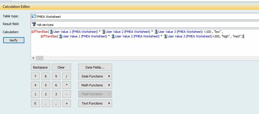

I am having a difficult time getting my risk level to follow my RPN.  My risk level and matrix are setup for a high, medium, and low.  Where low is green, medium is yellow, and high is red.  What I am trying to get to is if my RPN is less than 125 my risk level is green, 125-200 is yellow and anything over 200 is red.  Any help would be great.

Check attachment and create similar calculation....
Define this in the Project Navigator > Setup > Calculation
Be sure that you defined values as Number not Text
And define required datas
( think like uservalue1=severtiy uservalue2=occurence uservalue3=detection)
and lists
(low - med - high) in the example
