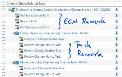

Windchill report for reworks within tasks AND change notices
Version: Windchill 13.0
Use Case: In our change notice flow I have options to "Rework" at the ECN workflow level and also within the change activities as part of the ECN. I want to get a report to count the reworks overall per ECN but seem to be able to get either just the activities, or just the ECN reworks and not both.

In our ECN flow there are rework routes within the ECN workflow and also within the Change Activity workflows:
All of the above work but they end up only showing the reworks within the ECN workflow and don't display the change activity reworks.
If I go this route with looking at assigned activities, I get the workflow processes for both the ECN and the activities, but as soon as I add the change notice table, the activity data drops off.
With change notice added:
What am I missing to consolidate reworks within an ECN that counts both the ECN reworks AND the task reworks within it?

I think you need to put an outer join to the link to the ECNs table, so that the report extracts data even if the assigned activity is NOT linked to this table.
Marco

Once I add that outer join I get the change tasks with their reworks and the ECNs with theirs... but there's no relationship between the ECNs and Tasks. In other words, I can get the task number for an ECN and then look for the number of times that task shows up. That's a secondary operation though.
What's the best way to get the ECN to show both the number of reworks within it's flow AND to tie in the associated tasks as part of it's implementation plan for the total sum of reworks?
