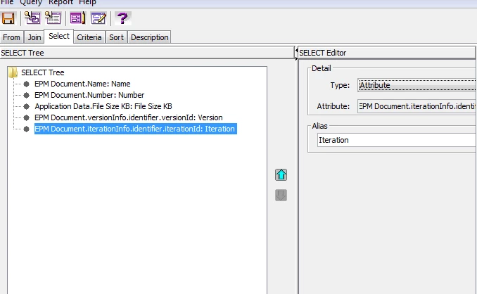

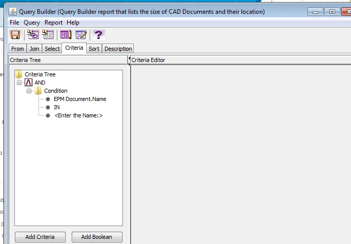

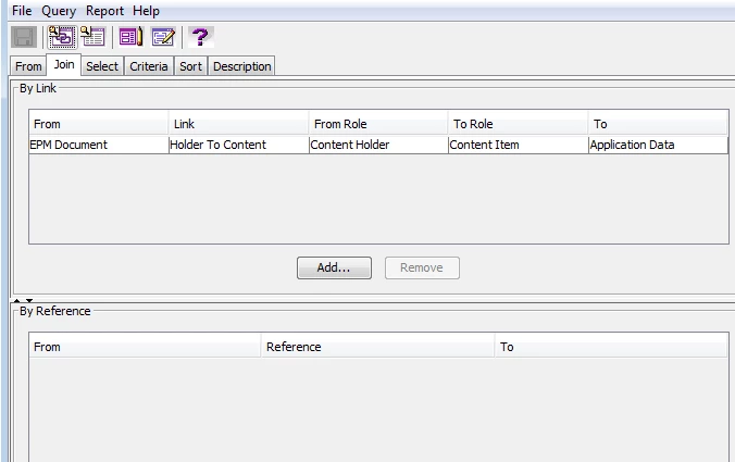

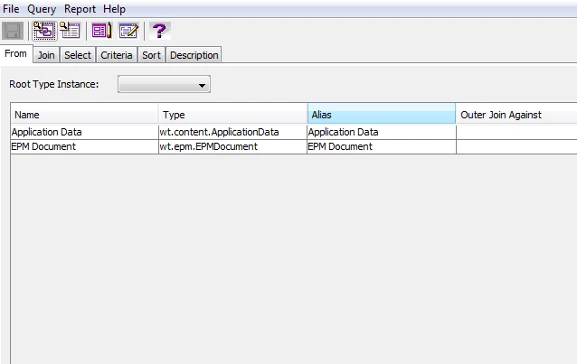

I want to generate report with a date range but I don't know what attribute that I'm going to use. To generate a report that shows all of the drawings within the specific date range.
The FF. attachments is the attribute that I used but there is no date range it only just show all the Report that lists the size of CAD Documents.

I don't know PDM essentials but, starting from Windchill 10, it's no more necessary to use query builder criteria to have start and finish date.
You can select the kind of date you need then, when you run query builder report from Windchill GUI, you can select from a list of possible date criteria (today, yesterday, this month, last year, start date, finish date, ecc. )
