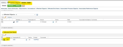

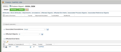

Hi everyone.  I am trying to add Affected End Items to a "Problem Report" report with Report Builder (Windchill PDMLink 11.1).  I have successfully done the same for a "Change Request" report using the below guide but this does not work in the same way for Problem Reports.  Can anyone help?  I need to know what kind of join and any additional tables to go between the Problem Report table and the Part Master table.

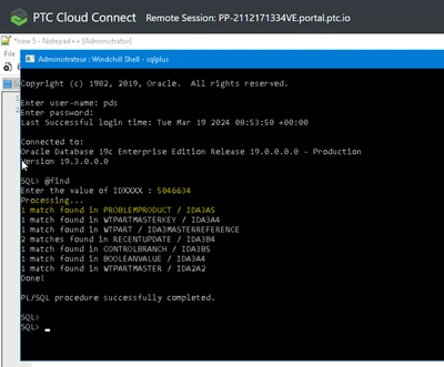

Hi , I don't have other points on specific joints , but I will tell you how I found the link .
1- created data set (PR with affected end Item)

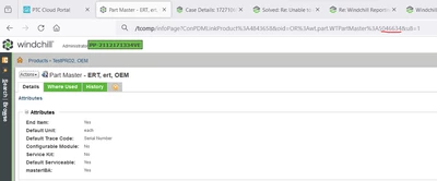

2- find the Ida2a2 of the PartMaster :
3- run Plfind script (attached the one for Oracle ) to find all references for the PartMaster ID :

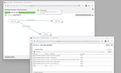

use table problem product :

better, I will share the entire report as zip ,and you can import it to your base , let me know if you need help with the import
