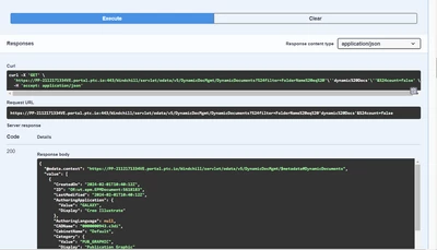

It kinda worked. However, I just realized that our xmls and organized in sub folders. Hence why I trying to work with the type. E,.g downlaod all xml documents with a certain subtype of DynamicDocument.
I scrolled down to our subtype in WRS, e.g. GET /DynamicDocuments/PTC.DynamicDocMgmt.Condition
But all I get is metadata. How can I get the latest version of the full xml document?

Can you share some screenshot , I don't follow you
