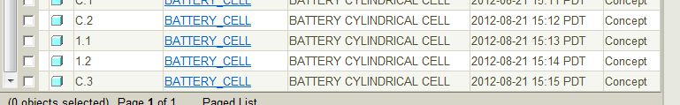

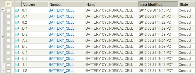

August 28, 2012
Here are some screen shots showing the out of order revisions on a test part we did. Intentionally seeing if the system would allow it. These are sorted by last mod date. Shows going from 0.1 to A.1 to back to 0.2 then B.1 and B.2 and back A.2 and then B.3 on to C's and 1.1+. The other shot shows going from a C.2 promoted to 1.+ then back to C.3. We purposely did this and the sytem is allowing check-ins of modified out of data.

Wow... Yes, big problem, it appears.
