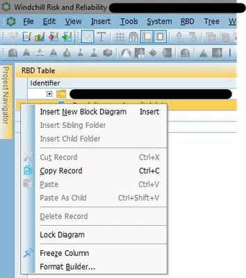

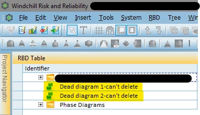

See Below: Two diagrams exist at the primary "Block Diagram" folder level, in the "RBD Table" view, cannot be deleted. There are no blocks in the diagram. They showed up when I inserted a new diagram by right clicking on the Primary Block Diagram folder, then selecting Insert - Normally this inserts a new diagram within the Block Diagram folder; not at the same level.. I am unable to delete, move, etc. They can be renamed and used as regular diagrams.
Has anyone experienced this? What did you do?
Right click on either diagram:
