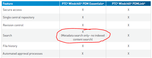

Hi All,
I just want to ask if windchill PDME can search a meta data contents?
example if you want to search a specific documents and you don't know the filename but you remember a word inside the content of that document.
Is windchill search capable of doing that? If yes, how?
Thank you in advance
Luar
TomU
Sep 8, 2016 12:05 PM UTC
Meta data (document attributes), yes.  Document content (word inside the document), no.

Hi Tom,
Thank you for the answer. Where can I look the full copy of that feature? the  PDME and PDMlink comparison.
