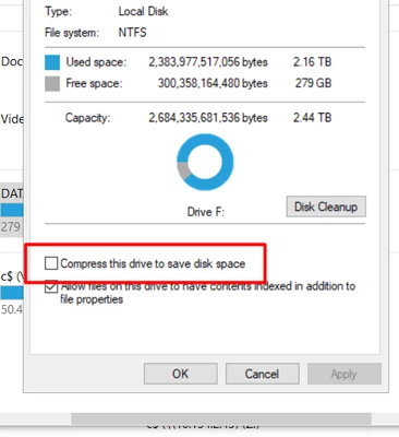

hello,
is the compression process that I mentioned in the photo risky for the live server?
For example, there are vault folders in the F disk. Can I use this compression process if I want to free up space?

A quick google search indicates that compressing disk will slow down things since it adds compressing and uncompressing to the overhead of retrieving files. I would not recommend this. Have you tried operations like purging and removing unreferenced files from your vaults assuming this is where your vault location is too? Also check into un-needed log files.

Hi Avillanueva,
Thank you for the answer. I clean log files and folders like instences, infoengine etc.
When I did this on my Windchill test server, I opened up 60 percent of space, but I didn't see the harmful effect because I didn't use it much.
There will probably be performance issues and I don't want that. I just wanted to ask. Thank you so much.
