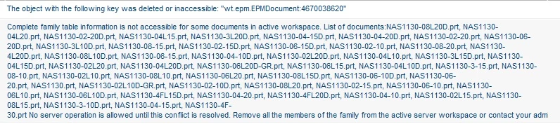

Below is error message I receive when trying to add NX part files to my Workspace.
I have exhausted my local and corporate support.
Months of running in circles only to get conflict messages a day later again.
Wondered if anyone might lead me in a helpful direction.
I have deleted and created many new Workspaces, that has been the "fix" from my support.
I have tried different server.
And looking at my error message, Wondering if the administrator (which I do not know who or where "they" are) needs to delete the part files listed in message.
THANKS for whatever I can find out.
Complete family table information is not accessible for some documents in active workspace. List of documents:NAS1130-08L20D.prt, NAS1130-04L20.prt, NAS1130-02-20D.prt, NAS1130-04L15.prt, NAS1130-3L20D.prt, NAS1130-04-15D.prt, NAS1130-04-20D.prt, NAS1130-02-20.prt, NAS1130-06-20D.prt, NAS1130-3L10D.prt, NAS1130-08-15.prt, NAS1130-02-15D.prt, NAS1130-06-15D.prt, NAS1130-02-10.prt, NAS1130-08-20.prt, NAS1130-4L20D.prt, NAS1130-08L10D.prt, NAS1130-06-15.prt, NAS1130-04-10D.prt, NAS1130-02L20D.prt, NAS1130-04L10.prt, NAS1130-3L15D.prt, NAS1130-04L15D.prt, NAS1130-02L20.prt, NAS1130-04L20D.prt, NAS1130-06L20D-GR.prt, NAS1130-06L15.prt, NAS1130-04L10D.prt, NAS1130-3-15.prt, NAS1130-08-10.prt, NAS1130-02L10.prt, NAS1130-08L10.prt, NAS1130-06L20.prt, NAS1130-08L15D.prt, NAS1130-06-10D.prt, NAS1130-06-20.prt, NAS1130.prt, NAS1130-02L10D-GR.prt, NAS1130-02-10D.prt, NAS1130-08L20.prt, NAS1130-02-15.prt, NAS1130-06-10.prt, NAS1130-06L10.prt, NAS1130-06L10D.prt, NAS1130-4FL15D.prt, NAS1130-04-20.prt, NAS1130-4FL20D.prt, NAS1130-04-10.prt, NAS1130-02L15.prt, NAS1130-08L15.prt, NAS1130-3-10D.prt, NAS1130-04-15.prt, NAS1130-4F-30.prt No server operation is allowed until this conflict is resolved. Remove all the members of the family from the active server workspace or contact your administrator.

Had my "permissions" re-granted early yesterday morning.
Finally got in touch with the correct people.
Sure was nice to finally get it figured out and fixed.
Appreciate the advice here also.
THANKS
