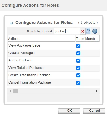

This could be controlled by two items. You can get lots of good information on them in the Windchill Help Center.
  • Container Profiles
    • Container, Team, Configure Actions for Roles
  • Container Policies
    • Container, Utilities, Policy Administration

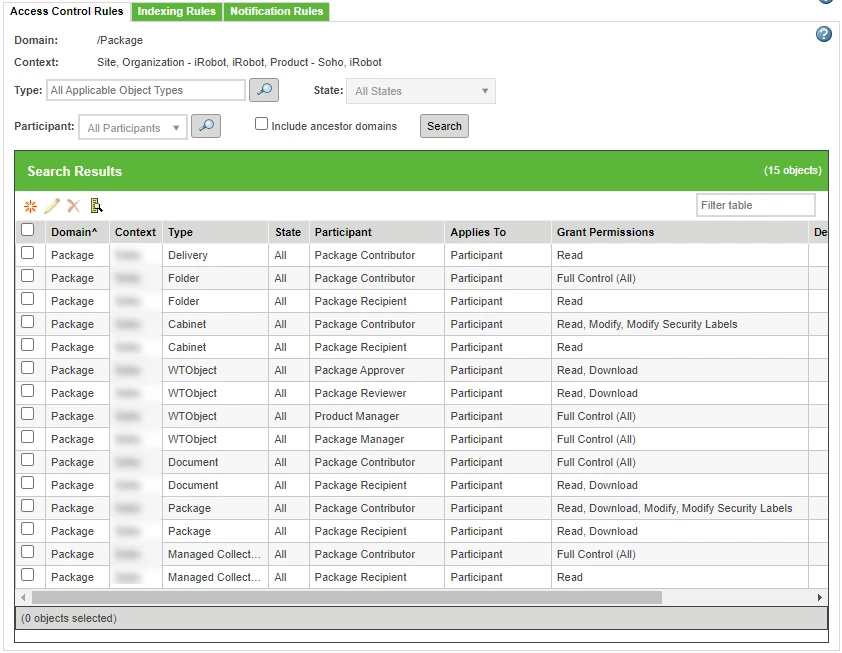

Hi Scott,
If in the Configure Actions for roles I belong to a group that has permissions to create packages, I should be able to create packages correct?
With the image below what container policy(s) for package would need to exist to allow the creation of a package?
example:
Package | context | Package | All | Package Contributor | Participant | Read, Download, Modify Security Labels
I'm assuming the above line won't allow you to create a packages correct?
Do you need full control for Folder, Package, Managed Collection or other types to create a package?
FYI, We are not using WTObjects currently.
Thanks for any insight you may provide!
Don A
