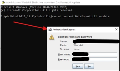

Use Case: I had to add/update the data formats .mp4 .avi .. to the existing formats "MPEG Movie Clip"
Description:
When i follow the guide "Updating Data Formats" in the Help:
Enter the following command to update an existing data format:
java wt.content.DataFormatUtil -update
In a environment with SSO i don't get the "Authorization Request" i can't turn off the SSO in this env.
So the guide is not working with SSO for me
Without SSO here is the request
Is there another workaround except turn off SSO ?
Best answer by mmeadows-3
It depends on how you have SSO configured.  The Windchill command is just Java with a wrapper.  Generally, we can substitute 'windchill' for 'java' anywhere PTC a Windchill shell.  Then follow this article for passing the SSO username.
https://www.ptc.com/en/support/article/CS63015
Use windchill --javaargs="-Dwt.auth.trustedAuth.username=username" wt.content.DataFormatUtil -update
There are a few other tricks if that doesn't work.
