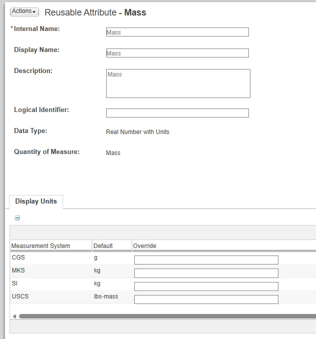

I have created all the mass properties as global attributes as real numbers with units.
The example I will show is the mass, which has the standard QOM of Mass.

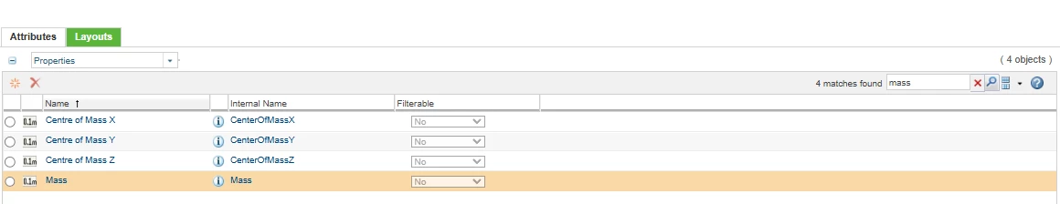

Not sure where I am going wrong - I have tried to ensure names are identical everywhere.

could be your mass data type in SW is “text” you would need to match that in Windchill or vicea versa

Your comment was very helpful, as I realised Solidworks stores “Mass” as text, and the numeric version is “SW-Mass”
However, that doesn’t work either seemingly, but when I do use it the other values populate

What does your Solidworks mass mapping looking like in Type Attributes?
