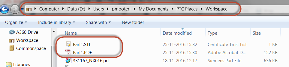

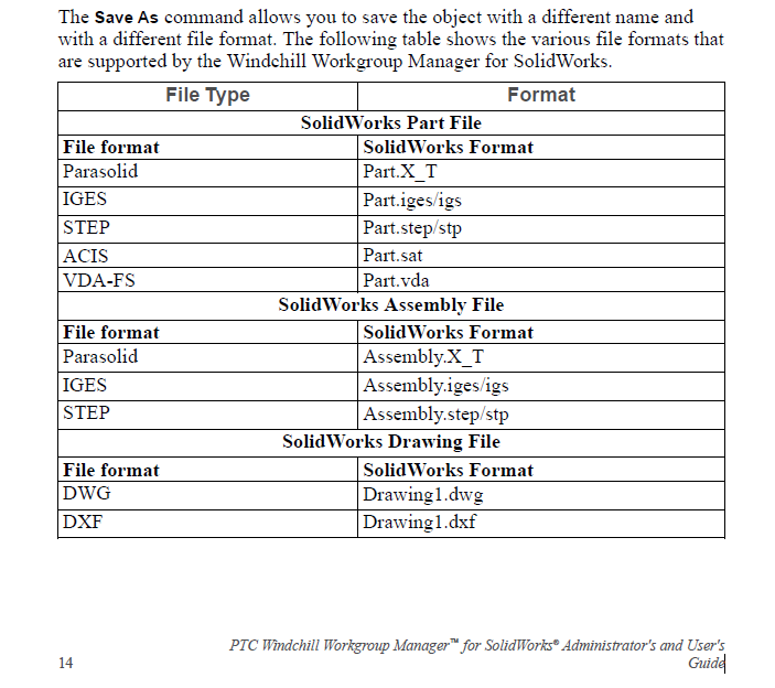

When SolidWorks is registered in Windchill Workgroup Manager, it saves all the files to active workspace location. In Save As, below types are supported in WGM connected mode.
If you are using 10.2 & higher version of Windchill Workgroup Manager, then you can find those files locally at default location similar in your system. But these two file types are currently not managed by Windchill Workgroup Manager.
