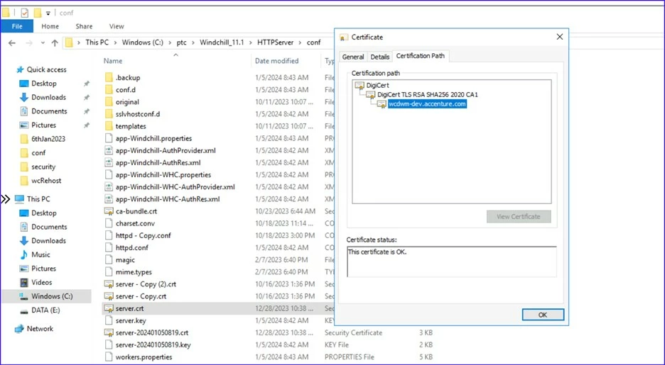

Hi Community,
I have recently configured Windchill Server for my client with SSL CA Signed certificate downloaded from DigiCert.

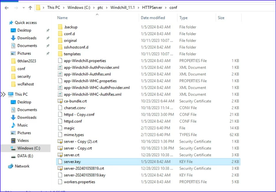

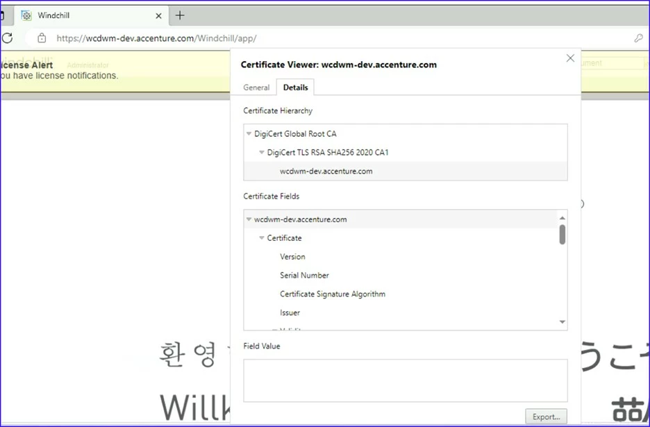

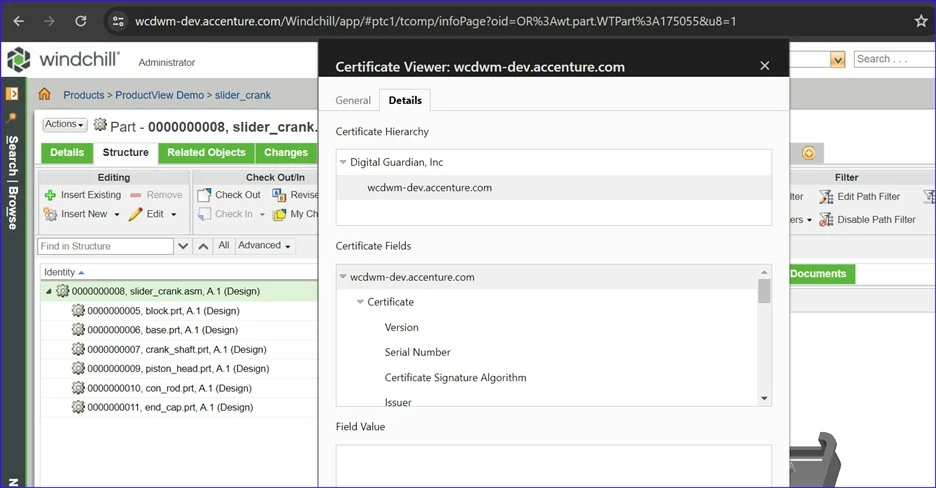

I have replaced server.crt and server.key in Apache and restarted Windchill Server. Currently url is showing secured connection inside VM(might be because SSL certificate is installed on server) but if I am trying to access the URL outside VM, it is showing secured connection but not following certificate hierarchy. (Root-Intermediate-Individual) - Issue is intermediate certificate is missing if accessed outside VM. Attaching Screenshots for reference. Kindly suggest how I can resolve this issue.
Siddharth

Are the chain certs in the trust store on the non-servers? In your server.crt is it just the end cert? if so, it should be the concatenation of the entire chain of certs
You can do this with cmd (or manually create a text file concatenating all certs)
type windchillserver.crt intermediate1.crt intermediate2.crt root.crt > concatenatedserver.crt
The concatenated server cert should look something like this:

Also, be sure to import your chain into your java keystore. I always start with the root and work down the chain to the server cert. Once you import and accept trust of the root cert, java should trust each subsequent cert... if it doesn't, you know there is a problem with your chain

pushd %wt_home%\..\HTTPServer\bin
openssl pkcs12 -in D:\PTC\Certs\server.pfx -nocerts -out D:\PTC\Certs\server.temp.key
openssl rsa -in D:\PTC\Certs\server.temp.key -nocerts -out %wt_home%\..\HTTPServer\conf\server.key
openssl pkcs12 -in D:\PTC\Certs\server.pfx -clcerts -nokeys -out D:\PTC\Certs\server.crt

  • server.key is just the server's private key.
  • server.crt should only include the server's public certificate.
I've never tried @jbailey's suggestion to put the full cert chain in the server's public cert file.
Maybe that eliminates having to load the certs on root and intermediate certs in the clients' computer certificate stores?
  • The ca-bundle.crt file should include the root and intermediate certs in order, but not the server's cert.
