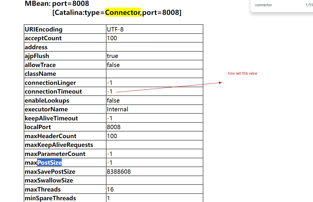

windchill super big bug
Apache Tomcat all thread, sometime hang
SocketInputStream.socketRead0 ,but cpu is very low。
os Windows server 12
windchill version 10.2 m230
Sometimes the CPU of the two front-end method servers is somewhat increased, but they do not perform gc at the same time. The same point is running this code SocketInputStream.socketRead0 。It is a system-level snow and does not involve specific operational functions.

i give  problem code:

There is not enough information to assist you. You did not include Windchill version or OS. Let the field know what you've tried or if this is related to a certain action. The partial error message you posted is very generic and not helpful. I would also not classify this as "super big bug" since it may just be a tuning issue.
Jul 23, 2024 9:09 AM UTC
i find no tomcat connector timeout value.please tell me how change the timeout value
