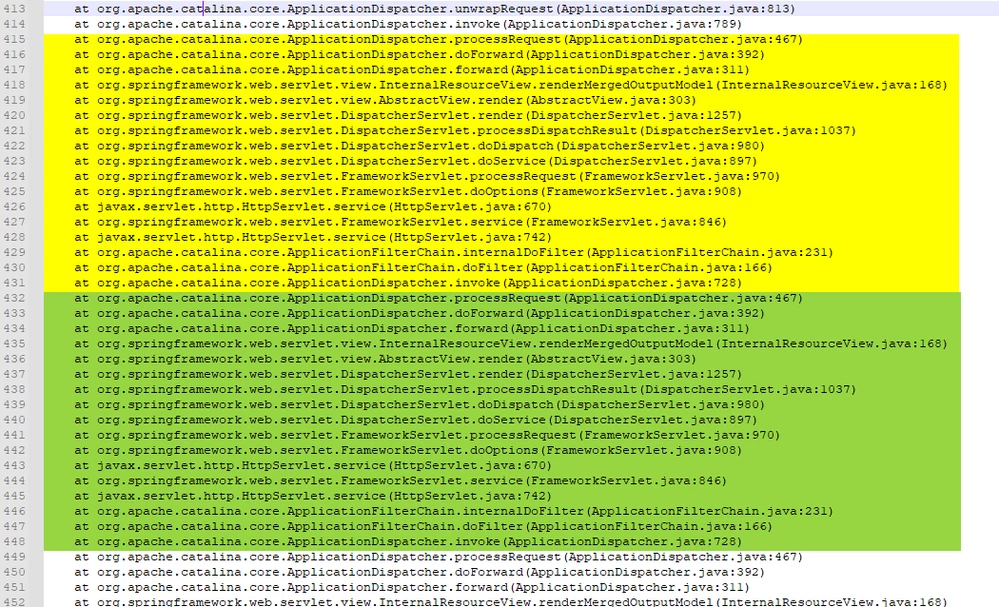

Windchill System MethodServers crash and restart due to "java.lang.StackOverflowError"
I am using Windchill PDMLink Release 11.0 and Datecode with CPS M030-CPS07
This has happened twice in the last week, and it is causing outages of my PROD Windchill System for about 5 mins whilst the FG MS's all restart (it takes out all four FG MethodServers, but not BGMS).
How do I discover what is causing this - because the logs don't give any detail, just loads and loads of the of the errors?

If you know exact time, when the error appear you could check Apache log and check what user actions where run and then you could just guess what was that. What part of Windchill it could case..
From that error it is hard to say what is a root case.
 for me very suspicious is org.springframework.web.servlet.view.InternalResourceView.renderMergedOutputModel
some work with visualization and model in a structure which case fatal error,
Sometimes it is memory or some never ending loop in application and so on.

I am no Java expert, so not sure how to read the stack traces to see what the cause was, but my understanding with stack overflows is to look for the repeated functions (as it is likely stuck in a recursive loop that then consumes all heap) - so I presume this is the loop it is stuck in:

Many thanks Jeremy - I will look into this and "Accept as a Solution" if it turns out to be this.
Any ideas what the "HTTP OPTIONS method" referred to in the article is all about? I do see some of these requests in my Apache logs and, apparently, Windchill does not use this method OOTB (but we do have a customised system that might - I will look into this further).
I wondered if these "HTTP OPTIONS method" calls were an indication of someone attacking our Windchill System too...
Sep 7, 2022 1:25 PM UTC
Prior to this SPR I had never heard of of the OPTIONS method before. Searching the web I see the web client can send a OPTIONS request to the server for a URL, then server will respond with the permitted methods for that URL. Some common methods are GET, HEAD, POST, and PUT,
Not sure why you have OPTIONS method calls. I reviewed the internal notes of the SPR, but didn't see any indication what generates an OPTIONS request for an invalid URL. Does seem like a common problem, there's 28 customers linked to the SPR.
