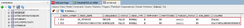

Ensure there are indexes on table wtgroup

The information you mentioned is all normal
We have rebuilt the wtgroup table before, is it related to this?
Moreover, there is this information in the log
at oracle.jdbc.driver.OraclePreparedStatement.executeQuery(OraclePreparedStatement.java:3867)
