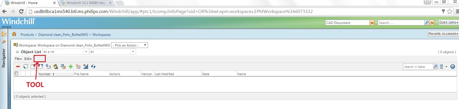

Windchill tool option not available
why Windchill tool option is not available in windchill PDMLink? for more information please refer attached.
can you please help me.

Hi Sharan,
Did you check this in embedded browser, it should be visible there.

HI Bhushan,
Can you please give me some more clarity, i am not getting what is embedded browser.

Aug 9, 2016 2:07 PM UTC
You will have to login to workspace from Cad Tool e.g. Creo and the action should be visible.
