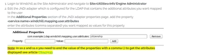

I didn't see <service.name>.windchill.mapping.user.attributes like the below image.

Oct 4, 2023 6:35 AM UTC
Good Morning Mr. Anvil,
I need more details on this JNDI adapter & how I can create this. Kindly provide the steps for this.
  1. Login to Windchill as the Site Adminstrator and navigate to Site>Utilities>Info*Engine Administrator
  2. Edit the JNDI adapter which is configured for the LDAP that contains the additional attributes you want mapped to the user
    In the Additional Properties section of the JNDI adapter properties page, add the property <service.name>.windchill.mapping.user.attributes
    enter the attributes (comma separated) you want mapped as values for this property
    Note: In 10.2 and 11.0 you need to end the value of the properties with a comma (,) to get the attributes displayed see article CS247033
