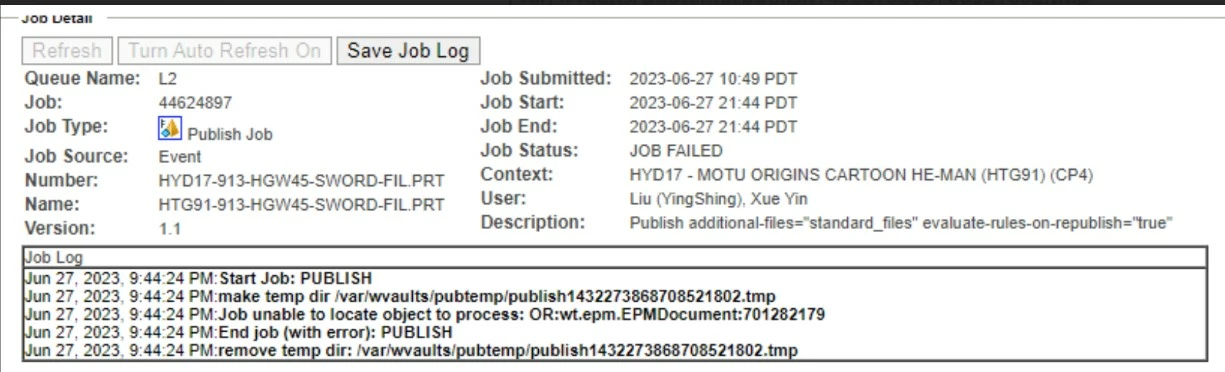

We have got aprox. 500 jobs failed to publish with bellow error in worker log.
Job Log
Jun 27, 2023, 9:44:24 PM:Start Job: PUBLISH
Jun 27, 2023, 9:44:24 PM:make temp dir /var/wvaults/pubtemp/publish1432273868708521802.tmp
Jun 27, 2023, 9:44:24 PM:Job unable to locate object to process: OR:wt.epm.EPMDocument:701282179
Jun 27, 2023, 9:44:24 PM:End job (with error): PUBLISH
Jun 27, 2023, 9:44:24 PM:remove temp dir: /var/wvaults/pubtemp/publish1432273868708521802.tmp
Can someone help tp resolve this issue?
Please find attached file for error

This seems to be an issue with collecting the cad data
 could be due to access, vault
I would suggest looking at the background method server/ methodserver logs to find the relevant error which will point to issue

HI Vishwas,
Thanks for your reply.
However if  I republish the same job from Representation tab in windchill browser using Create new Representation option it is getting published successfully.
But if publish the same job from WVS job monitor it fails.

Hi @RP_10484037
The issue can be in an access of the visualization user.
If the system send something to the visualization under visualization user, the user needs to have the access to all files. So visualization user should be an administrator.
This can be just one of many reasons, why the visualization process can not find some documents.
