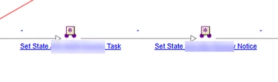

Use Case: We are looking to implement lifecycle state synchronization between Change Notice and Change Activity in Windchill. Specifically, we want the lifecycle state of a Change Activity to automatically update based on the state of its associated Change Notice—and vice versa. While reviewing the workflow configuration, we noticed the object event "Change Notice State Change". We would appreciate guidance on how this event functions and how it can be leveraged to achieve bidirectional state control between Change Notice and Change Activity. Could you please advise on: How this event can be configured within workflows? Whether lifecycle transitions can be triggered automatically in both directions? Any best practices or limitations we should be aware of?

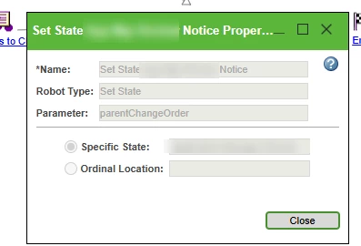

It is very easy to do with a Method Robot.  Use parentChangeOrder as below.  I've only done this in Activities.
