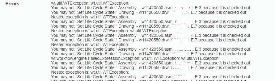

Hi Guys,
i am facing workflow stuck issue. it is not moving to next person for approval. image attached.
please help.
Sandeep C.

HelesicPetr
Jan 11, 2024 9:21 AM UTC
Hi @Sandy7
If the process is promotion request where the changing state is done automatically to the locked state then the data have to be checked-in not check-out.
Check in the data and create new promotion request.

Sandy712-AmethystAuthor
Jan 11, 2024 9:27 AM UTC
Hi @HelesicPetr ,
it is actually CN. i checked those assembly and drawing. it is in checked in state only.
br,
sandeep

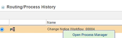

HelesicPetr
Jan 11, 2024 9:38 AM UTC
Hi @Sandy7
The error shows different information
It seams that your WF is stacked when it should have changed the states.
You need to open the actual workflow find the node where the wf is stopped and finish the node manually as a administrator.
PetrH
