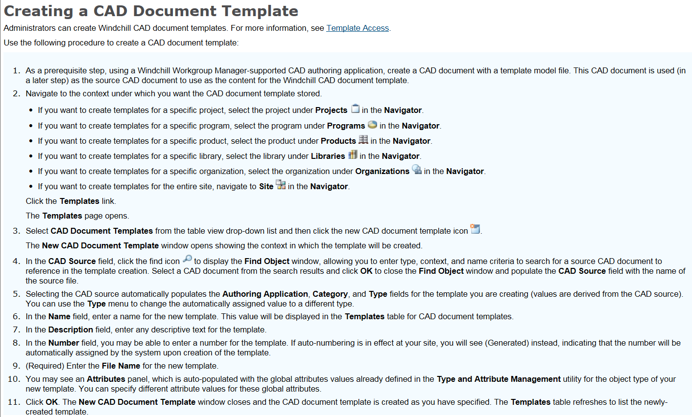

All I want to do make the existing SW templates active in Windchill, so when I start a new part from workgroup manager it opens new parts in SW correctly.

I need a simple step-by-step instruction of how setup Windchill using my existing part PRTDOT, assembly ASMDOT and drawing DWGDOT templates.

Hi Gerard,
In Windchill Workgroup Manager Help Center (Windchill Workgroup Manager>Help>Help Center), if you search for "Creating a CAD Document Template", you will find below content. I agree that, it is a generic documentation, but it can be used for the template file formats that you would need to create in Windchill. Please let me know, if you require further clarification.
Pasting content below for ready reference.
Pankaj Mooteri

Jun 2, 2017 4:42 PM UTC
Hi Gerard,
Please follow the below steps:
1. Register the required server and workspace in WWGM.
2. Open the templates in Solidworks (you can import only the templates having extensions .prtdot, .asmdot, .drwdot into windchill)
3. Save the opened template to the workspace by clicking ‘Save to Workspace’.
4. Open the WWGM, Select the template & Perform Check-In.
5. Repeat the above steps for the remaining templates that you want to import into Windchill.
6. To verify the added templates, log on to Windchill, navigate to the location where the templates were Checked In.
Thanks & Regards,
Irfan
Hope it helps you resolving your issue.
