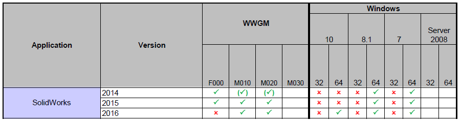

We use Windows 7 and Windows 10 for all of our CAD workers (including SolidWorks).  The WGM matrix does not appear to support any server OS for SolidWorks.
http://support.ptc.com/WCMS/files/168115/en/Windchill11.0M020CADIntegrationMatrix_12616.pdf

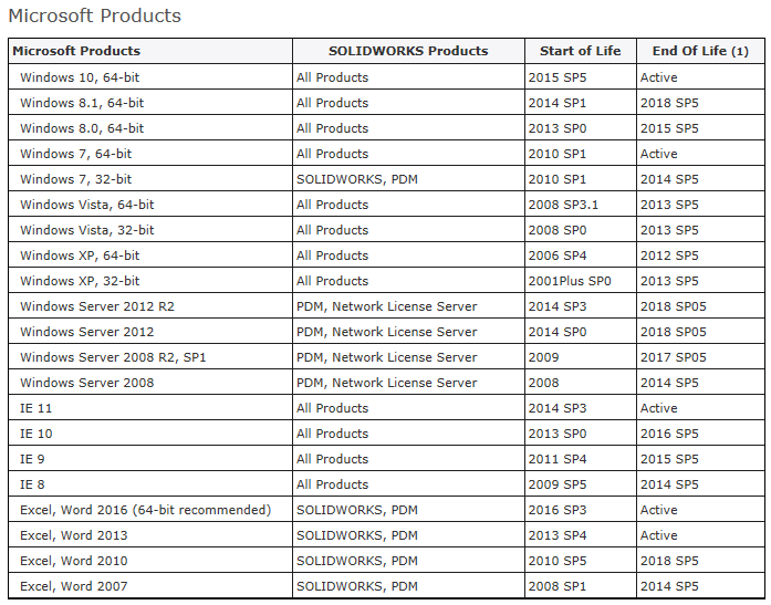

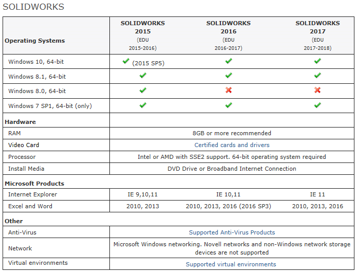

More info from SolidWorks:  SOLIDWORKS | Hardware & System Requirements | SOLIDWORKS
I would be surprised if PTC would support running the SolidWorks WGM on a server OS when Dassault does not support running the SolidWorks software on a server OS.  Not saying it won't work, but it sure seems like it would be unsupported.

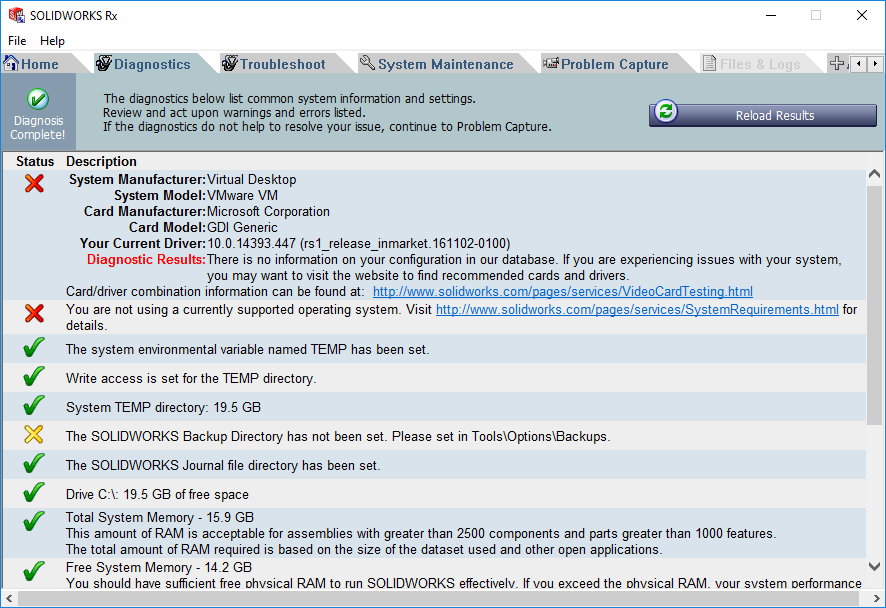

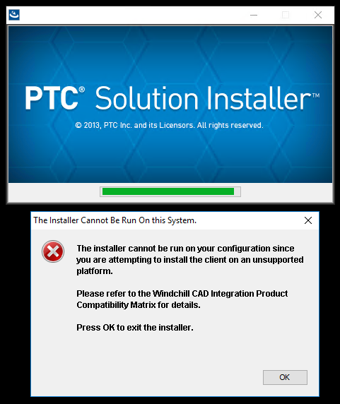

Just for fun I went ahead and tried it myself.
Windows Server 2016 Standard, Windchill 10.2 M030 CPS18
  • SolidWorks 2016 SP05 Installed fine
  • Java 8 Installed Fine
  • Windchill Workgroup Manager will not install.
By the way, even though SolidWorks seems to run fine, diagnostics does recognize that this is an unsupported OS.
Jan 5, 2017 5:32 PM UTC
We have this problem too. The WGM installer will not start on our Windows Server OSs (2012 or 2008).
We have been working around the problem by copying the WGM folder from a Windows 10 machine, then run this command:
c:\ptc\wgm\x86e_win64\obj\uwgm_client.exe -autoreg_only -uwgm_nographics -out c:\ptc\wgm\register.log
You will also need to install WFS manually:
msiexec /i C:\ptc\wgm\installer\PtcVfs.msi /l C:\ptc\wgm\installer\logs\PtcVfs_manual_install_after_msicuu.log
