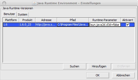

Windows 7 and PDMLink 9.1 M050 Workflow Administrator
Our NASA center is pushing Windows 7 out to the community and we have found that when you go to the Workflow Administrator to view or edit a workflow, a blank screen appears. There are no errors thrown in the Java console(we are using 1.6.0_23). We have a call in with PTC, but so far they are stumped. Just curious if anyone else has seen this. Thanks and Happy Mardi Gras to everyone!

I have seen that. The workaround that I found was to dumb down my Windows7
display mode from True Color 32 bit down to 256 colors. It's not a great
solution but it will at allow you to work with the Workflow Admin page. And
it should also give PTC the clue they need to resolve it. It seems like the
Java 2D graphics API and Windows 7 display drivers are not happy together.
On Windows 7 to change the display mode it's : RMB on wallpaper > Screen
Resolution > List all modes

If there's a Java API vs. graphics driver issue on Windows, then the
solution is to add one or more properties to the JVM options to disable
some of Java's use of Direct* APIs. This is done via the Java Control
Panel.
The primary option to try is
-Dsun.java2d.noddraw=false
This turns off Java's use of DirectDraw and Direct3D completely. See

Hi Bill,
just try to set
-Dsun.java2d.d3d=false
As startup parameter in your Java Runtime Settings
