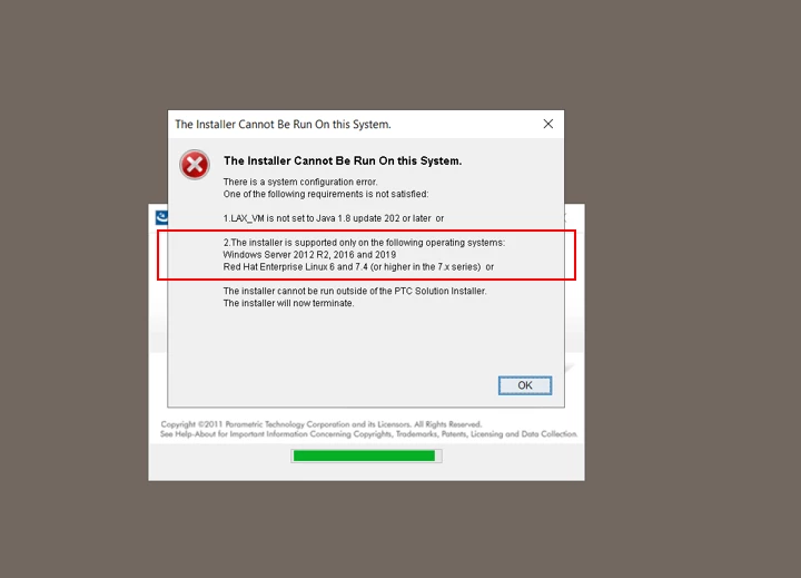

Hello, has someone tried to install Windchill pdmlink on Windows Server 2022?
I tried critical PTC Windchill 12.1.1.3 Service Pack - Critical Patch Sets Bundles and just to try PTC Windchill PDMLink 12.1.2.0 but both are not supported on this new Windows
18-Opal
Dec 30, 2022 2:14 AM UTC
Are you sure the problem is not variable LAX_VM?
If you’re not sure try setting it. It should point to <jdk 11 Dir>\bin\java.exe

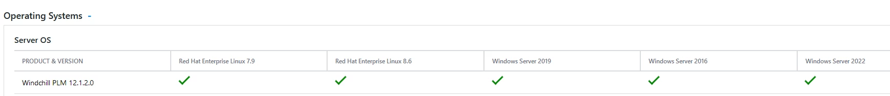

Jan 11, 2023 8:50 PM UTC
12.1.2.0 is supported on Windows 2022. (See attached image from support matrix). My guess is that you are not running the correct setup.exe file to launch PSI. Because 12.1.2.0 does not have a CPS bundle, you need to download "PTC Solution Installer 12.1" from the PTC downloads. Most recent datecode (12-1-2-0) which is 257MB. When you extract that, run the setup in that folder.
