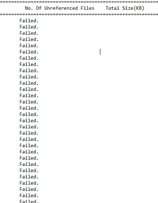

Use Case: While running the unreferenced file check from WinDU the txt file has no of unreferenced files as Failed. What does this mean ?

Does the number of failed lines correlate with anything like the number of folders you have? A good place to look deeper would be the methodserver logs at the time of run to see if it threw an error. I have never run this task before but I think it would require that vaults are healthy, validated and mounted. Clearing our unreferenced files is a periodic task that should be done to free up HD space.

November 8, 2025
Provide the complete Methodserver log generated during running the WINDu task will be helpful for understanding the report
