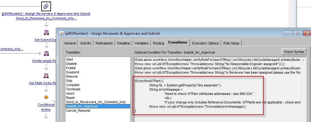

Perhaps I need to clarify.
My issue is the users can COMPLETE TASK, without Checking the box, therefore, it is not 'really' required
22-Sapphire I
August 22, 2013
Only way we know is to add some "validation code" on the Complete transition.
August 22, 2013
Is the variable declared on the activity or in the process? I would use an object so Boolean at process level undefined and copy to/from but make it required at the activity. Just to see how that affects the behavior.
