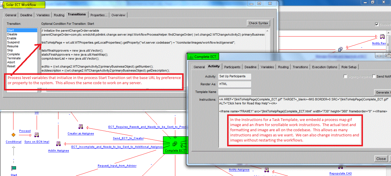

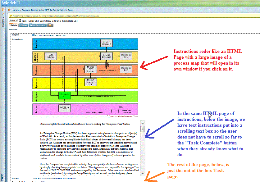

For the last 8 years or so, we have used embedded HTML in the workflow template task template instructions to include a GIF process map as well as scrollable work instructions. The GIF and work instructions live in the codebase, allowing us to have as many characters and images as we like. We can also change the instructions and images without having to restart the workflows.
Note how the base URL changes in the workflow Start transition allowing every server to get a unique server name without having to change the workflow code. The name of the server is saved in a preference or property of each system, but accessible by API to insert into the workflow as a variable for use in the task instructions.

Al,
Very cool. Embedding frames is one of the things I had thought about.
But then I thought an iframe that stored instructions that could be dynamically changed might not be the best for our business. Sometimes users would like to "go back" and see what the task looked like to the user 3 or 6 months ago, say. If the iframe source was changed after that...then when looking at the user's task from 3 or 6 months ago would render the current instructions instead of the old instructions.
Nonetheless, that should not rule it out as a possibility. It is possible that the iframe source is never changed. Instead, when the instructions need to be changed, create a new source for the iframe instead of updating the existing. Then modify the workflow to point to the new new location of the iframe source. Using that practice would result in displaying the correct instructions as the user saw them 3 or 6 months ago.
Thanks for the input, Al! This is very beneficial.

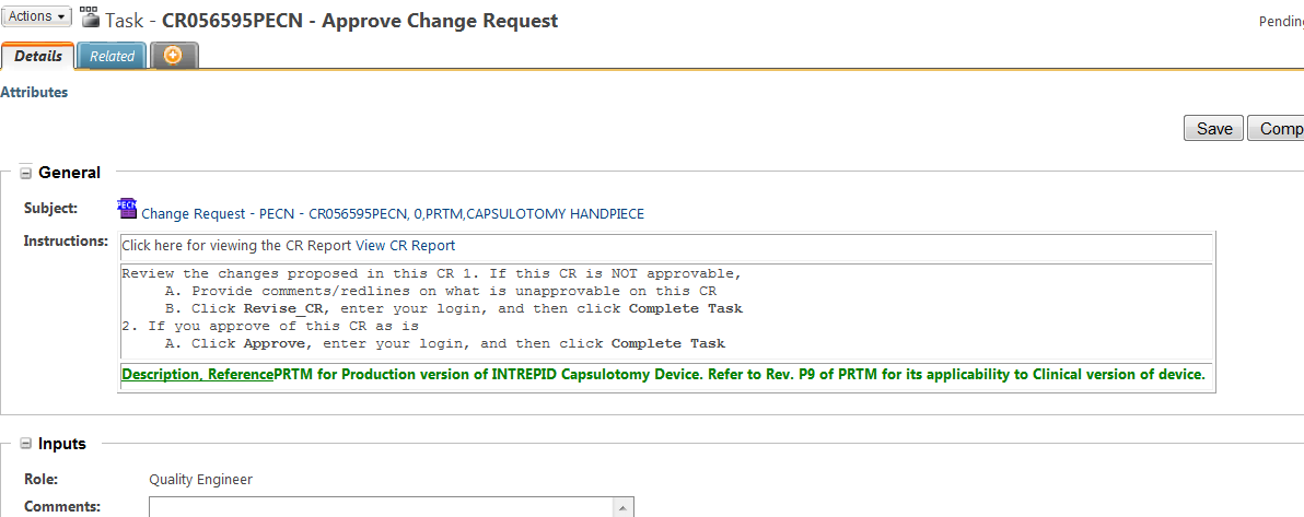

One thing I have done here in Alcon to externalize instrutions into the XML files sitting in the codebase. This has worked very well for us. We do not have to through verification process because the workflow template is not changed. The instructions can be changed instantly and these changes are server independent.
Al, I like the idea of embedding the images for the process flow...That is my next thing to do 🙂
I removed out of the box tabs which we do not use here in Alcon..
We also put PBO number as first thing in the task name, which is the most useful thing I think for the users to sort their work. We also have link created which takes them PBO report about the change (View CR Report) and display description of the change for user convenience.

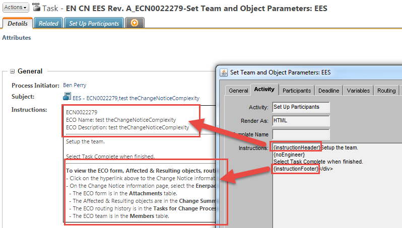

I thought of another idea to get around the 1333-character limit in the workflow task instructions (as outlined in CS61259).
If there is a group of common text that is displayed on all tasks, assign that text to a variable. Then in the instructions, call out the variable. I'm not sure how taxing this is on the system, but it is functional. A screenshot is included below. I also include the source code to populate {instructionFooter}. This can be put in an Execute Expression robot or somewhere in the workflow template.
instructionFooter = "<hr size=\"1\" width=\"100%\" color=\"#000\" noshade /><b>To view the ECO form, Affected & Resulting objects, routing history, Implementation Plan, and team:</b>\n" +
"- Click on the hyperlink above to the Change Notice information page.\n" +
"- On the Change Notice information page, select the <b>Enerpac ECO Information</b> tab.\n" +
" - The ECO form is in the <b>Attachments</b> table.\n" +
" - The Affected & Resulting objects are in the <b>Change Summary</b> table <i>(use the <b>Enerpac Default</b> table view)</i>.\n" +
" - The ECO routing history is in the <b>Tasks for Change Process</b> table.\n" +
" - The ECO team is in the <b>Members</b> table.";

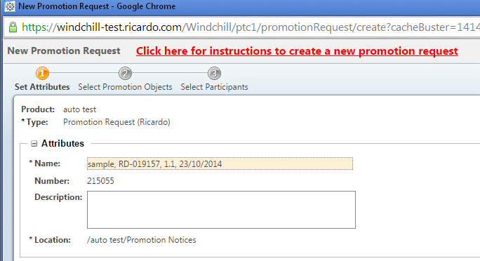

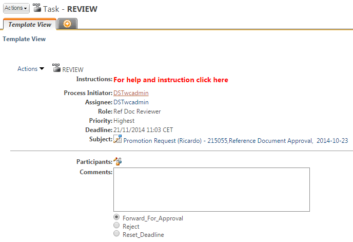

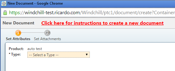

We prefer to keep the task page clean and simple and have removed all instructions. Instead we have a "click here for instructions" hyperlink which takes the user to the relevant page in our Windchill User Wiki. I find it helpful not to hard code detailed instructions. That way we can offload the creation and continuous improvement of user documentation to non Windchill admins, and we don't need to role out new versions of the workflow just to make edits to instructions.
Similar story for workflow email notification.

Darren, when you link like this, are the links to Windchill WTDocuments? If so, have you found a way to link to the latest Version of the Document?
thanks
Oct 29, 2014 8:22 AM UTC
Mike,
These particular links redirect to an internal wiki site, they are not Windchill Documents. To be honest we did not even try. My preference for this type of user help documentation is to open in a separate browser tab, for convenience and the to ability quickly redirect onto different help pages.

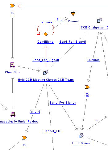

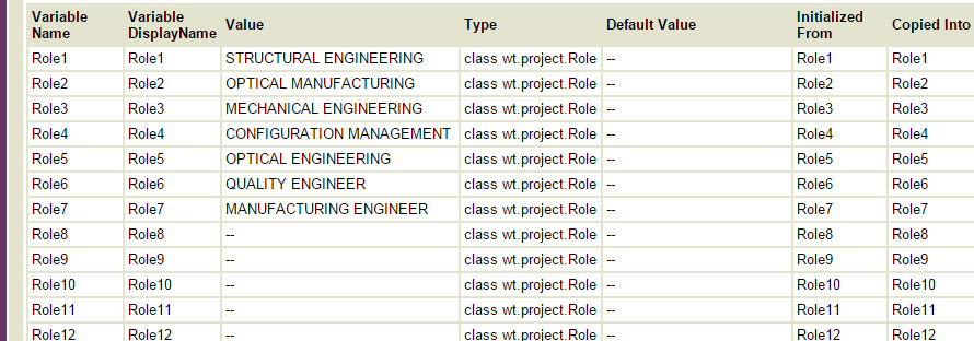

Ok, still using 9.1 but will see if I need this in 10.x soon. This is to date my grand achievement. I needed a single workflow that can route a parallel task to an set of roles not known before the workflow started. I used a signoff task that contained 20 role variables as slots or placeholders for roles. A manager picks from a workflow task from a list of team templates (just sets of roles) from the Product context (I have documented this other places). The workflow then takes those roles and populates them into the 20 slots. The unused slots just deadend to the administrator since undefined. When the signoff task fires, it looks up those roles from the change object team and delivers the task to those users defined by those roles. I used to have to modify and create a special workflow for each area that had a different signoff team. Now I have one workflow for the entire system and each product can have more that one team to choose from.
Still with me? The conditional does some cleanup task based on behaviours out of the box. First, when the emails are sent out using role variables, it does not use the role variable value when telling the user what role they are participating as. I therefore do not let the signoff task email the user but rather have this conditional create email messages for them. The users does not see a difference. Second, the extra tasks that deadended to the adminstrator would clutter the assignments list. I found a way to delete those thereby having the task only wait for the actual signatures of the roles that were populated in the task.
If you have fought the workflow editor with branches and conditionals to fire tasks when certain conditions were right or had the user define each time who from the pool needed to sign, this solves all of that. Just a simple task with a drop down list, pick which team needs to sign, and that its. The task is delivered to only those roles and the people who fill those roles in the Product. Again, to date, my best work. And if you are wondering, it can be looped back through meaning that if it loops back, you can choose a different team and it operates the same as the first time.
