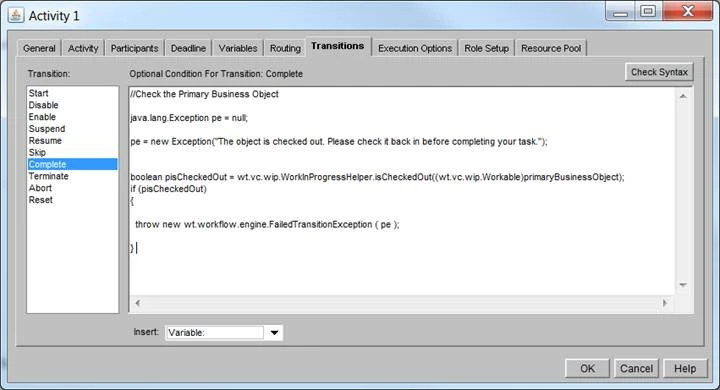

Is it possible to force the check-in of the PBO's in a workflow? I tried the Method Robot, but it just hangs on it.
That or, I want to re-assign the task to participant.

Hi Vaughn,
My suggestion is that you add an expression into the "Complete"
transition of the task.
In the example below, the expression checks if the object is checked out
when the user attempts to complete the task. If the object is checked
out, the user is presented with the error defined in the "new Exception"
statement and the task does not complete. If the object is checked in,
the task completes and the process moves forward.
Expression
//Check the Primary Business Object
java.lang.Exception pe = null;
pe = new Exception("The object is checked out. Please check it back in
before completing your task.");
boolean pisCheckedOut =
wt.vc.wip.WorkInProgressHelper.isCheckedOut((wt.vc.wip.Workable)primaryB
usinessObject);
if (pisCheckedOut)
throw new wt.workflow.engine.FailedTransitionException ( pe );
Hope this helps,
Dax

July 16, 2012
DAX,
This is exactly what I was looking for, thanks!
