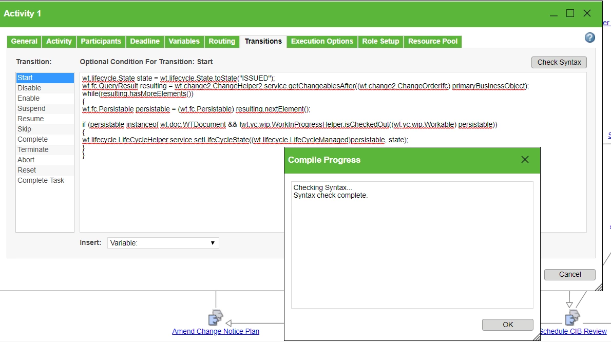

Following code as in https://www.ptc.com/en/support/article?n=CS260605&source=Case%20Viewer
To set the state of a Change Notice's Resulting Objects in Windchill
I am on WC  11.1 M020-CPS03
using the following Code in expression Robot:
wt.lifecycle.State state = wt.lifecycle.State.toState("ISSUED");
wt.fc.QueryResult resulting = wt.change2.ChangeHelper2.service.getChangeablesAfter((wt.change2.ChangeOrderIfc) primaryBusinessObject);
while(resulting.hasMoreElements())
wt.fc.Persistable persistable = (wt.fc.Persistable) resulting.nextElement();
if (persistable instanceof wt.doc.WTDocument && !wt.vc.wip.WorkInProgressHelper.isCheckedOut((wt.vc.wip.Workable) persistable))
wt.lifecycle.LifeCycleHelper.service.setLifeCycleState((LifeCycleManaged)persistable, state);
Here is the error in Compile window >> Check Syntax
Error: MS Logs

Jul 29, 2019 6:00 PM UTC
Kindly ignore previous comment. I saw that you are doing it from workflow robot. If you are trying it from Workflow, use below code:
wt.lifecycle.LifeCycleHelper.service.setLifeCycleState((wt.lifecycle.LifeCycleManaged)persistable, state);
Copy it in notepad first and then Paste it in robot. it should work.
