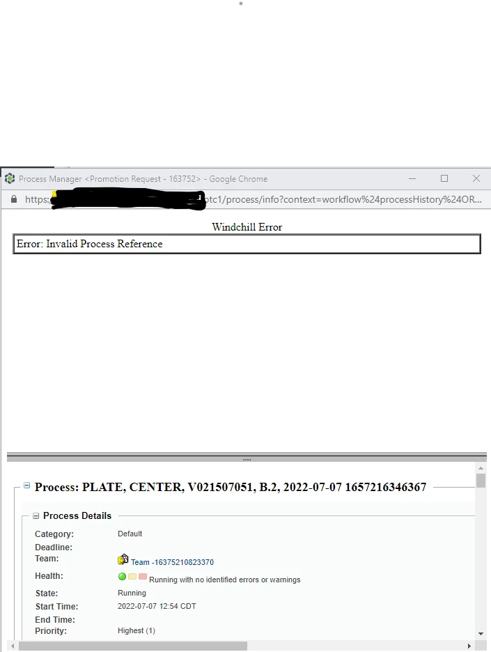

Workflow "Process Manager" no longer works after update from 12.0.2.7 to 12.0.2.8.
I have just updated Windchill from 12.0.2.7 to 12.0.2.8 and the workflow Process Manager no longer works. Doing a RMB > Open Process Manager opens the Process Manager as expected however the top pane shows "Error: Invalid Process Reference" instead of the work flow. The bottom pane shows the activities as expected.
Is there anybody else that has done this update and can confirm if you have this same issue or not?
I have opened a case with PTC yesterday but have not heard back yet from them.

I have discovered what the issue is. PTC changed codebase/apps/processmanager/processmanagergraph.jsp.  I have attached  processmanager.7z that contains 3 files:

It looks like they are attempting to add oid type validation. Basically PTC has added the following in 12.0.2.8:
Locale locale=SessionHelper.getLocale();
Pattern p1 = Pattern.compile("^OR:+wt.workflow.engine.WfProcess+:[0-9]{1,9}+$");//. represents single character
Pattern p2 = Pattern.compile("^OR:+wt.workflow.engine.WfBlock+:[0-9]{1,9}+$");
String oid = request.getParameter("oid");
boolean b = p1.matcher(oid).matches() || p2.matcher(oid).matches();
if(!b){
throw new WTException(new WTMessage("wt.workflow.work.ProcessManagerResource", ProcessManagerResource.PROC_INVALID_PROC_REF,null).getLocalizedMessage(locale));
So they are attempting to match something like this: "OR:wt.workflow.engine.WfProcess:2445483671"
They problem is they are only allowing 9 digits for the id and we are up to 10. The 2445483671 (an actual id from our system) is 10 digits long.

Their regex also matches this OR:::::::::::::::::wtXorkflow.engine.WfProcessssssssss:244548367 because they have a '+' after the first colon, they have unescaped '.', and they have a '+' after "WfProcess".
In processmanagergraph.jsp.fixed-12.0.2.8.txt you can see I changed the Patterns to this:
// fixed patterns
// Note the '+' after "[0-9]" to match any number of digits
// Note the escaped '.' with "\\." to force a match on '.'
// Note the removal of the '+' after the ':' and the WfProcess|WfBlock
Pattern p1 = Pattern.compile("^OR:wt\\.workflow\\.engine\\.WfProcess:[0-9]+$");//. represents single character
Pattern p2 = Pattern.compile("^OR:wt\\.workflow\\.engine\\.WfBlock:[0-9]+$");
// PTC's y2k patterns
So if your Windchill system still has ida2a2's 9 digits or less then the update to 12.0.2.8 (or I assume probably 12.1.1.2 upcoming) will not be an issue. However if you are like us with more than 9 digits then the update will break your Process Manager.

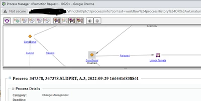

Hi Randy,
I've just patched our test server from 12.0.2.5 to 12.0.2.8 and the process manager works fine for me:
Kind regards,
Dmitry

Dmitry: Thanks for the confirmation.
