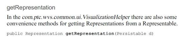

One thing I noticed in your pdf is at the bottom of page 1134 there is some over typing which will give you a head ache if you look at it too long.
[cid:image001.jpg@01CD493F.B22F8B40]

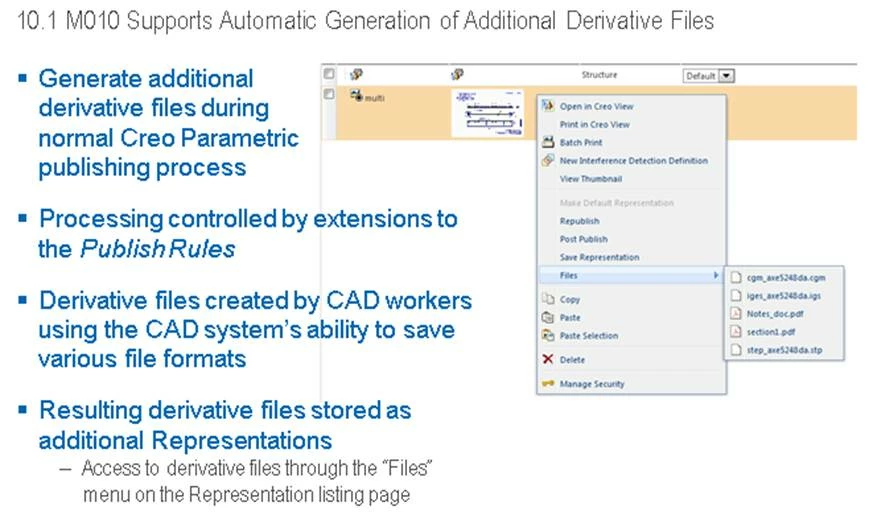

Somewhat along the same lines - in 10.1 M010 you will be able to get additional "derived" files:
[cid:image001.jpg@01CD4AD9.3C7FCEA0]
