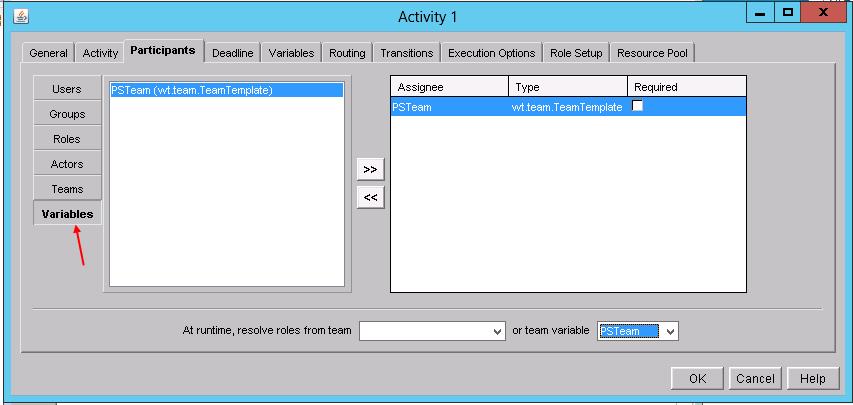

May 17, 2016 7:41 AM UTC
Pooja,
I don’t know your exact requirement. However instead of removing role form activity participant, you can create one workflow variable of team template type and  calculate the team before workflow activity in expression robot and then assigned activity to variable Team Template
Hope it helps
Shreyas
