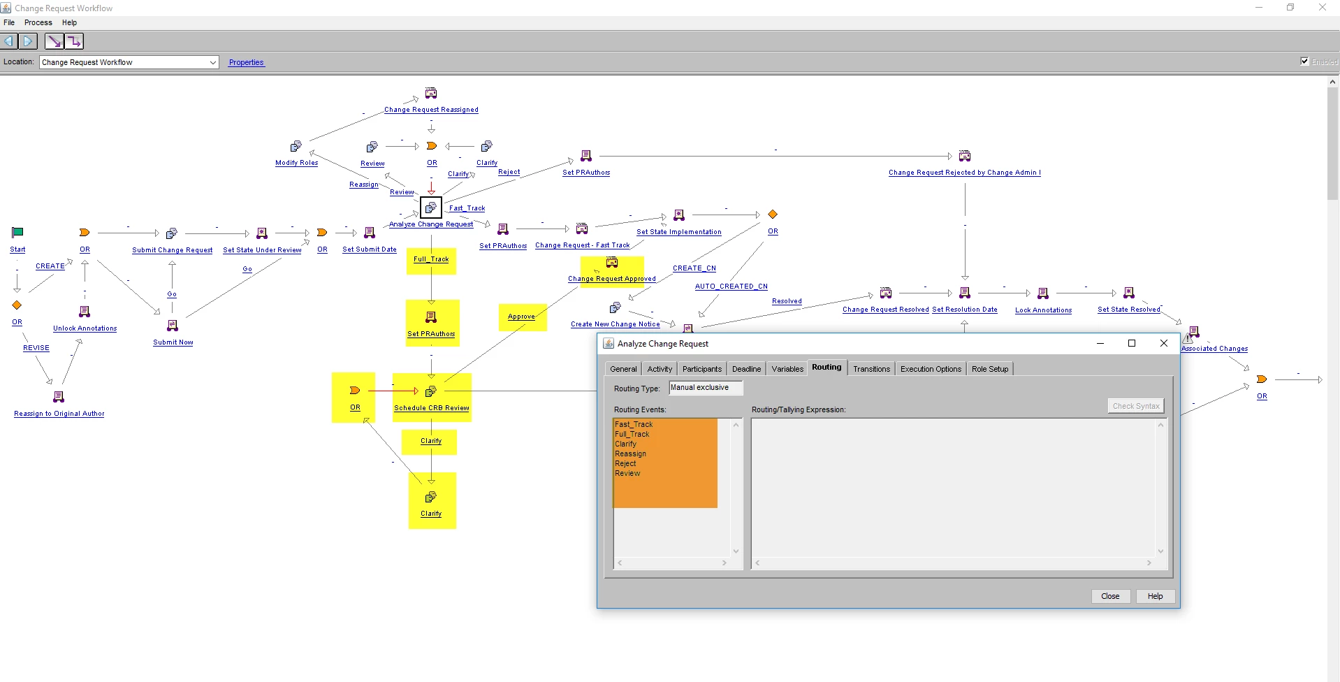

that's were I got stuck. I opened the template, opened the "analyse change request task" and found the routing options.
In the routing tab, there is no option to delete or add routing options (orange marked area in the screenshot attached).
I tried to delete all workflow elements related to the "Full Track" (yellow marked element in screenshot), but the "Full Track" routing option remains in the "analyse change request task".
Any tips on how to proceed?

You may be viewing rather than editing the workflow template.
