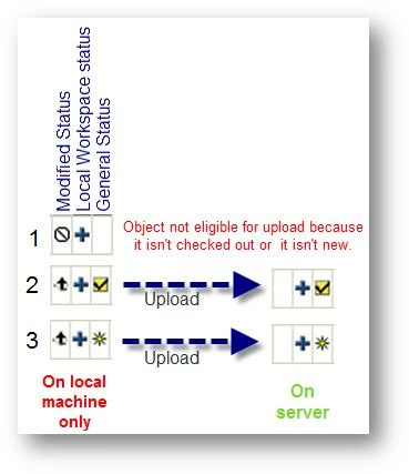

February 13, 2013
Hi Bob,
We try to train our users to look at their Workspace status in order to not lose work.
Here are the three scenarios for objects that are not uploaded:
[cid:image001.jpg@01CE09E0.474CC1A0]
Mike Foster
ATK
February 13, 2013
Mike,
Nice graphic, thanks.
I need to reevaluate the auto_upload_on_save Policy.
Bob
