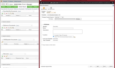

Hi Guys,  I need your help with this.
I have one WT part and I want to add local data, such as Word, TXT, and XML files. In the related object, we have a Described by Document and Reference Document. Right there, we can use that tab to create a new document and attach it.
Here, I want the name and number that I gave in the WT part to be the same as the ones in the WT document. It's possible.

Hi @Amirtharaj_K,
Do you want to see name and number of document same as part on loading of new WTDocument wizard?
or
its okay to have same name and number after creation of WTDocument?
Mar 15, 2024 5:13 PM UTC
Thanks for the replay @TDT
When we create a WT part i am using Name is Test and Number is 0001 when i create new document in reference document tab or described by document tab i want a same name Test and number is 0001.

Thanks for the replay @d_graham @Hari_Vara
I accept, but I made a mistake and will provide a different name/number. For example, I am only sharing those documents for particular departments, except for others. How can I find it? I need the name or number that is the same as the WT part.
Number - I can provide autonumbering, but at least I want the same name as the WT part name.
Because I am not creating an individual WT document and adding it to the WT Part Right. I directly create a WT document in the WT part. Even though we create it directly in the WT part, the document is saved separately. It's only a link to each other, right?
