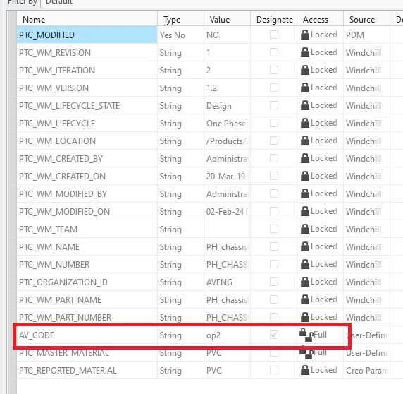

Here is the creo parametric parameters table screen shot
there is an internal value from the enumerated value list. So the propagation works from WTPart.
PetrH

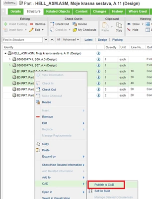

Yes if you propagate WTPart information to CAD Document
You just need to use Publish to CAD during check in operation
Also you can use a function from the Action menu on a WTPart detail page
PetrH
