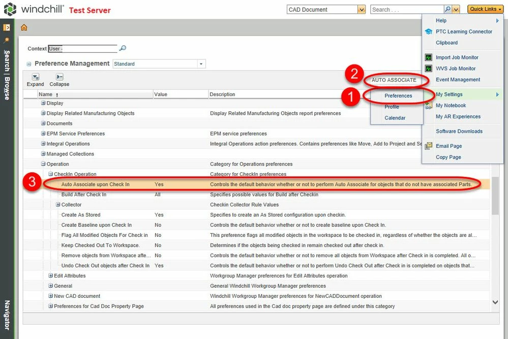

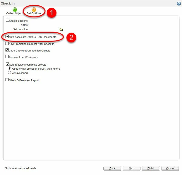

Have you tried the Windchill 'Auto Associate Option Upon Check In' Option? If that works, your Windchill admin can set this as the default for all users.

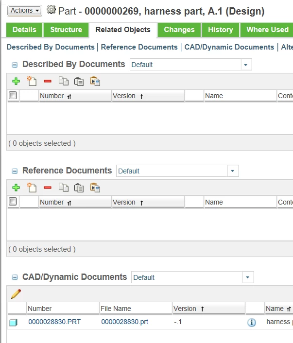

yes, I have and the part numbers do not match. That's what I am trying to fix. The Part dose associate to the Gear Part but I want the Gear Part and Part number to match. This is what happens when I do that.

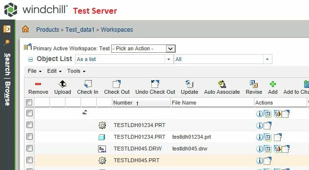

I attached is the OIR that we have on our Windchill Test Server for WTParts. As far as I know these OIR's are out of the box. I didn't see anything different with what you shared.CAD and Parts with Same Name OIR.jpg
