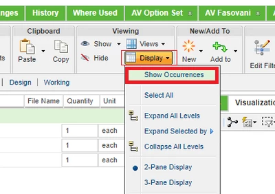

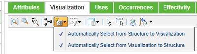

I am using Windchill PDMLink Release 11.1 and Datecode with CPS M020-CPS23
How to see in WT-Part Structure Visualization which Reference Designator is assigned to which Occurence in 3D?
When selecting a Part in visualization, I can't find any information which Reference Designator is assigned to it. Also when selecting any Occurence in the Occurence list, no object is being selected in the Visualization tab.
HelesicPetr
Jul 31, 2023 10:13 AM UTC
Hi @CHENAMA
Try to use Show occurances and then try to use select visualization. It should help you.

CHENAMA
CHENAMA14-AlexandriteAuthor
Jul 31, 2023 10:39 AM UTC
Wow thank you @HelesicPetr, that was almost too easy 🙂
