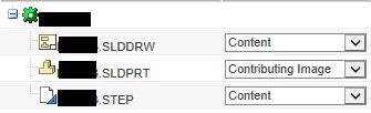

What is the best practice in associating drawings and STEP-files to WTParts?
At the moment we have Solidworks parts and assemblys which are associated to WTParts but we would also like to associate corresponding drawings (.slddrw and .pdf) and STEP-files to the WTParts.
I studied Windchill Help and I believe I should associate both kinds of drawings and STEPs with "Content" -type association. Is this correct?
Also, Windchill automatically associated SLDPRT with WTPart with "Contributing Image" -association. In my understanding, it should be "Owner" -type, but that type is not even available in the drop down menu. Is "Contributing Image" OK in this case?
