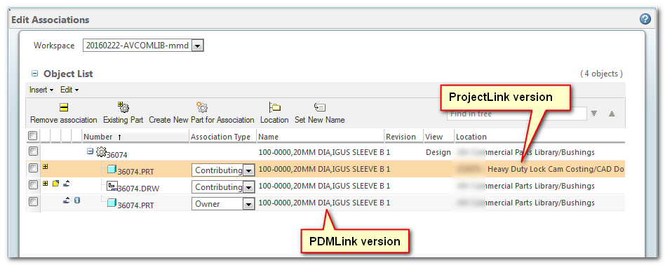

WTPart association in PDMLink wants to associate back to ProjectLink?
  • February 22, 2016
  • 1155 views
Anyone run across this before?
  • We created a part model and drawing in a project.
  • Sent both objects to PDM
  • Want to create a WTPart and associate it to the drawing and model.
  • Get an association back to the ProjectLink version of the model.  (See screenshot.)
I know that the ProjectLink object is coming from the drawing.  I can associate the WTPart to the PDMLink model correctly.
Any thoughts?
-marc
Best answer by mdebower
I logged a tech support call and found out that this is a known issue with Windchill 10.1 m040 and fixed in m050.  SPR 2172707
mdebower18-OpalAuthorAnswer
