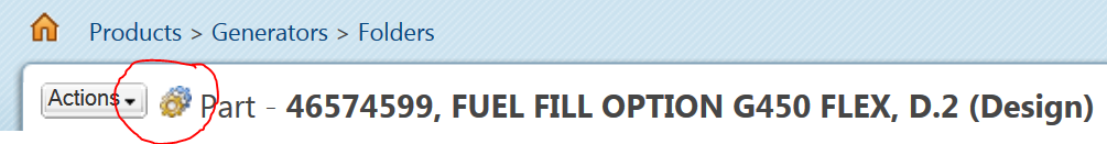

One of our Windchill wtparts has the below icon, when you hover over, it reads configurable module.
What is it?  How did it become that icon?  How do I change it back to the normal wtpart icon?

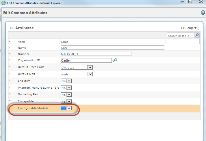

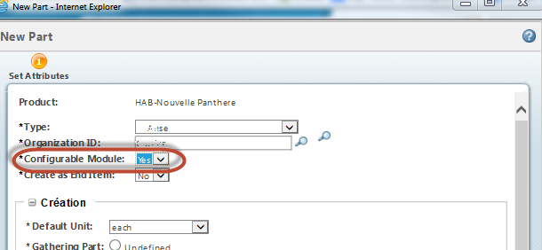

They have been created with attribute "configurable Module" to yes
You can modify it by Edit Common attributes for the Part Master
regards
January 31, 2017
Yes, that worked, but had to goto Windchill Preferences and set configurable module support option to yes so it would show up under Edit Common Attributes.  Apparently that wtpart was created when the preference was set to yes at one time.
