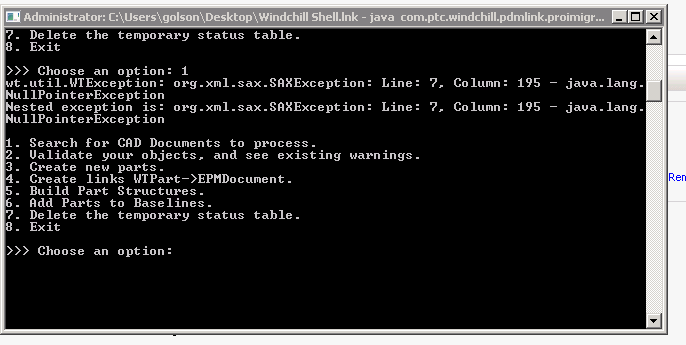

WTpart Creation Utiliy
Ideas on the attached error message "wt.util.WTException: org....."it's the return I get after step one.
Any assistance would be greatly appreciated.
Greg

Hello Greg,
I cleared the cache and restarted windchill to get past this error once.
Do you see anything in the MS logs other than this?
Thank you
Binesh Kumar
Barry Wehmiller
GregOlson16-PearlAuthor
Oct 6, 2015 11:39 AM UTC
I checked the MS logs and found that upper/lower case matters when pointing to a folder to create the parts in....now I am at step three with LC issues.  PTC is on it, but the initial TSE knew very little about this utility.
